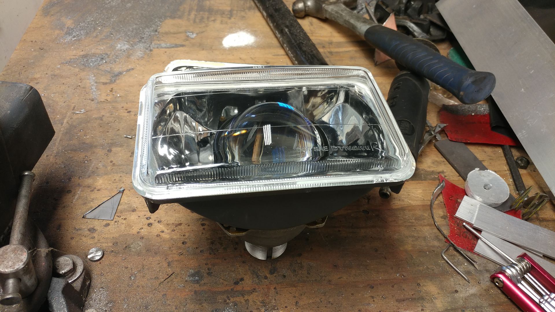

    I finally broke down (again) and bought some new projectors. I did my first set in 2012 and always had a sticky shutter for the brights/dims, even after replacing them.. just a design flaw in the Morimoto projectors I had.. Ive had a few different sets of projectors in my hands but none of them would fit the 4x6 housing so I just moved on in life and used my dims..

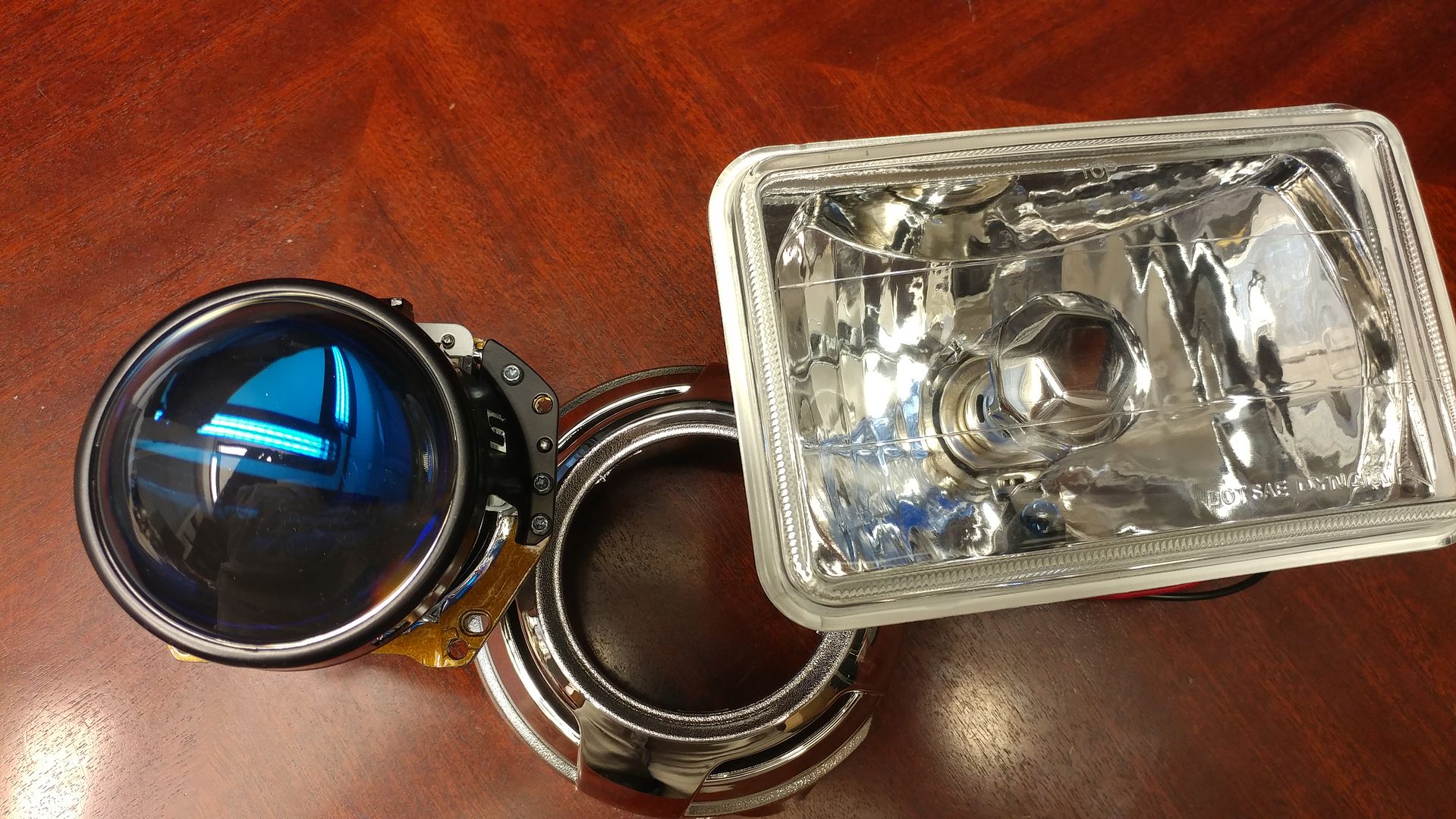

    The new projectors I ended up going with were sadly another set of Morimoto. Nothing factory would really fit that I had found. These are the mini D2s 5.0, Supposed to be the best out there now. These were also mostly sealed on back, unlike most factory projectors.
    I like to see at night.. and this is the correct way to run HIDs

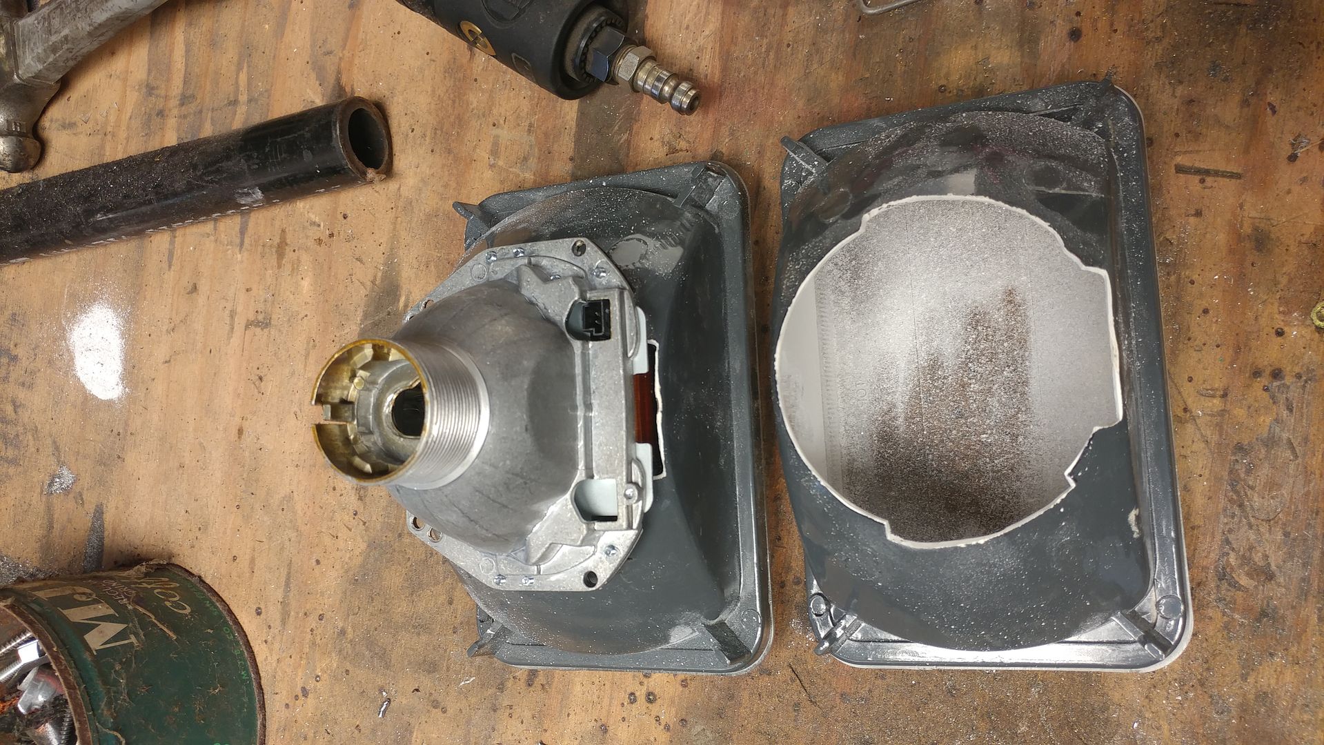

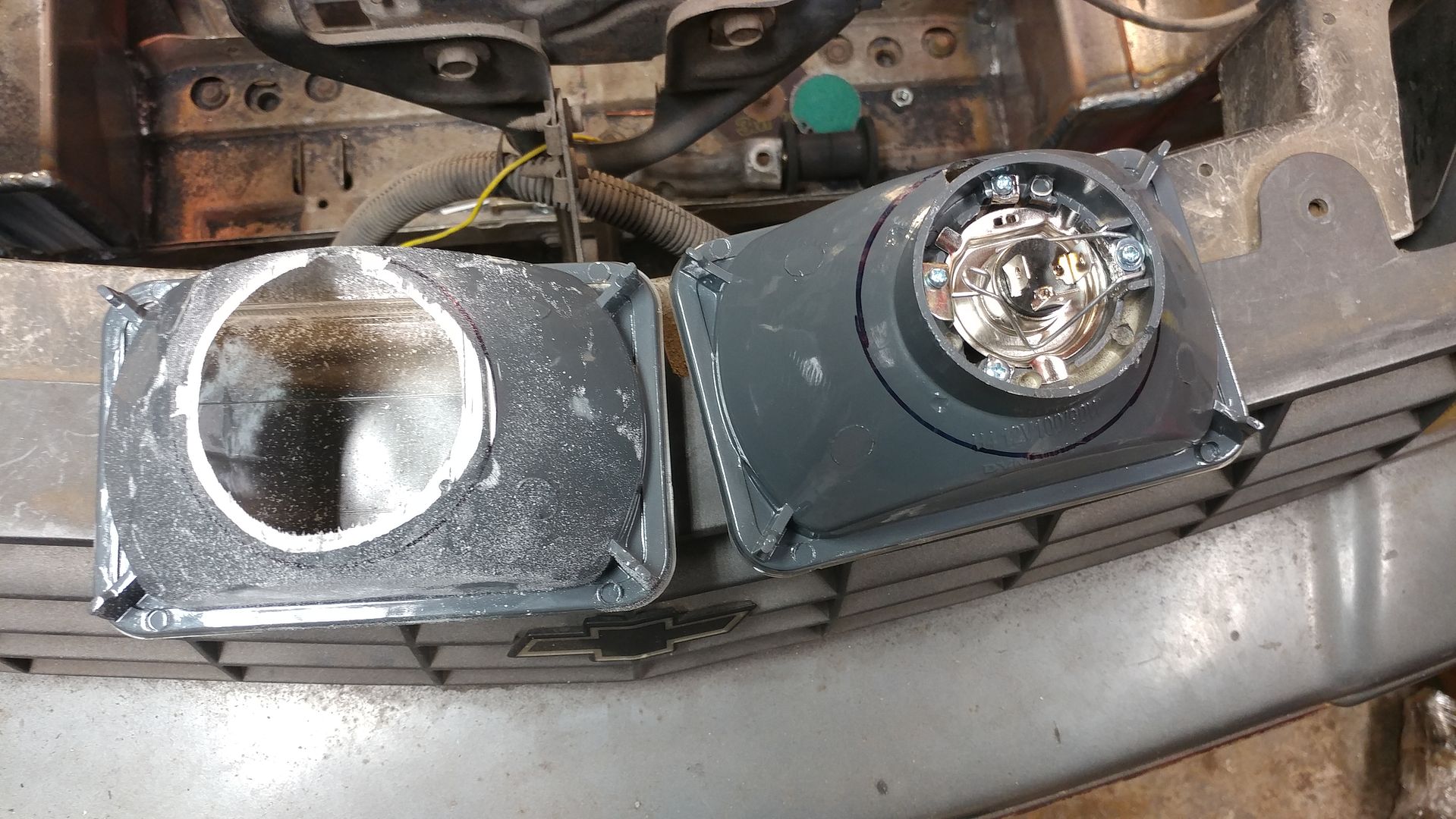

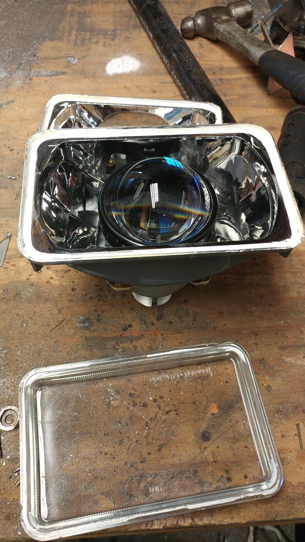

    I just used a cheapo ebay 4x6 housing

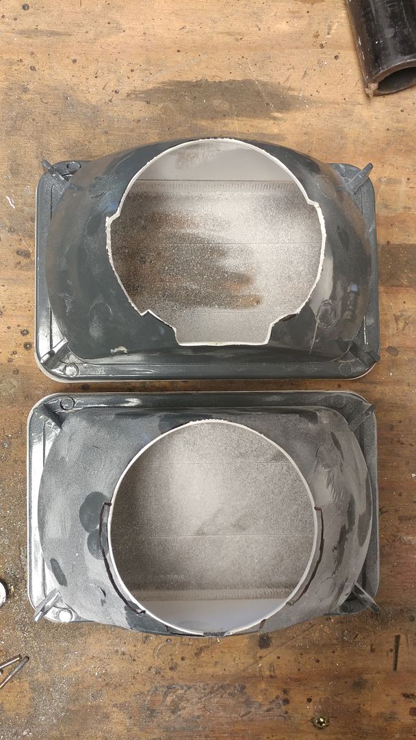

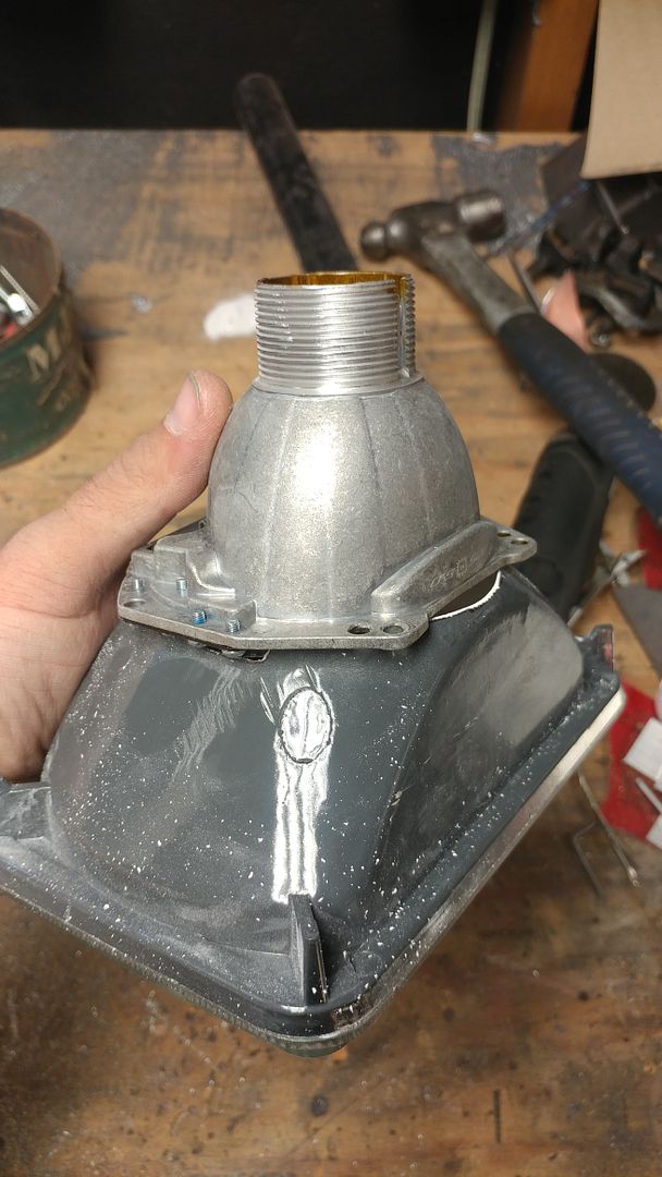

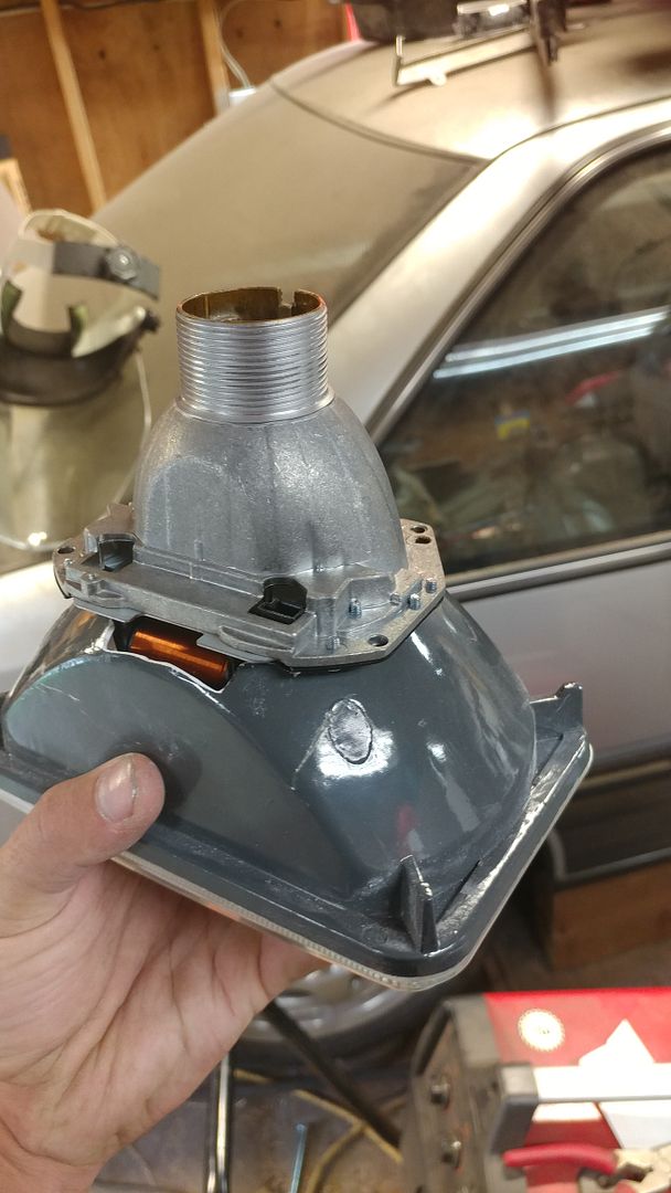

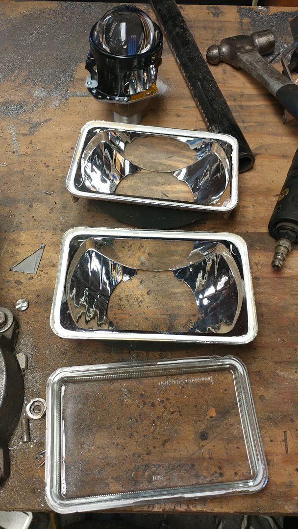

    I ended up using a roll of masking take to trace out the size I needed to start with, cut most off with a band saw and used a few different die grinders and sanding disks to make the rest happen. just ground out a little at a time. Its dusty.. the dust sticks to everything..
    Kept going until the projector almost touched the glass lense

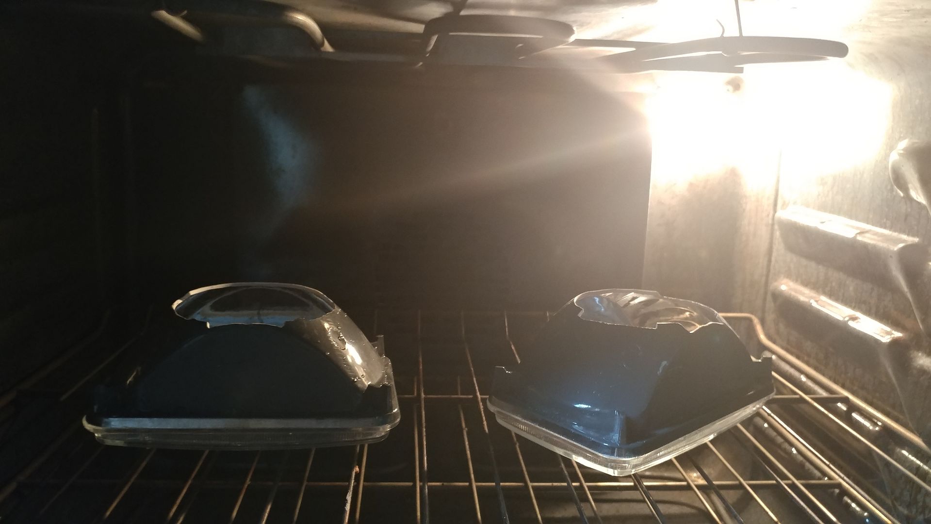

    put them in the over for awhile to soften the glue at 200*, still had to take a razor to them. I did chip a few edges on the glass, but it will be covered up.

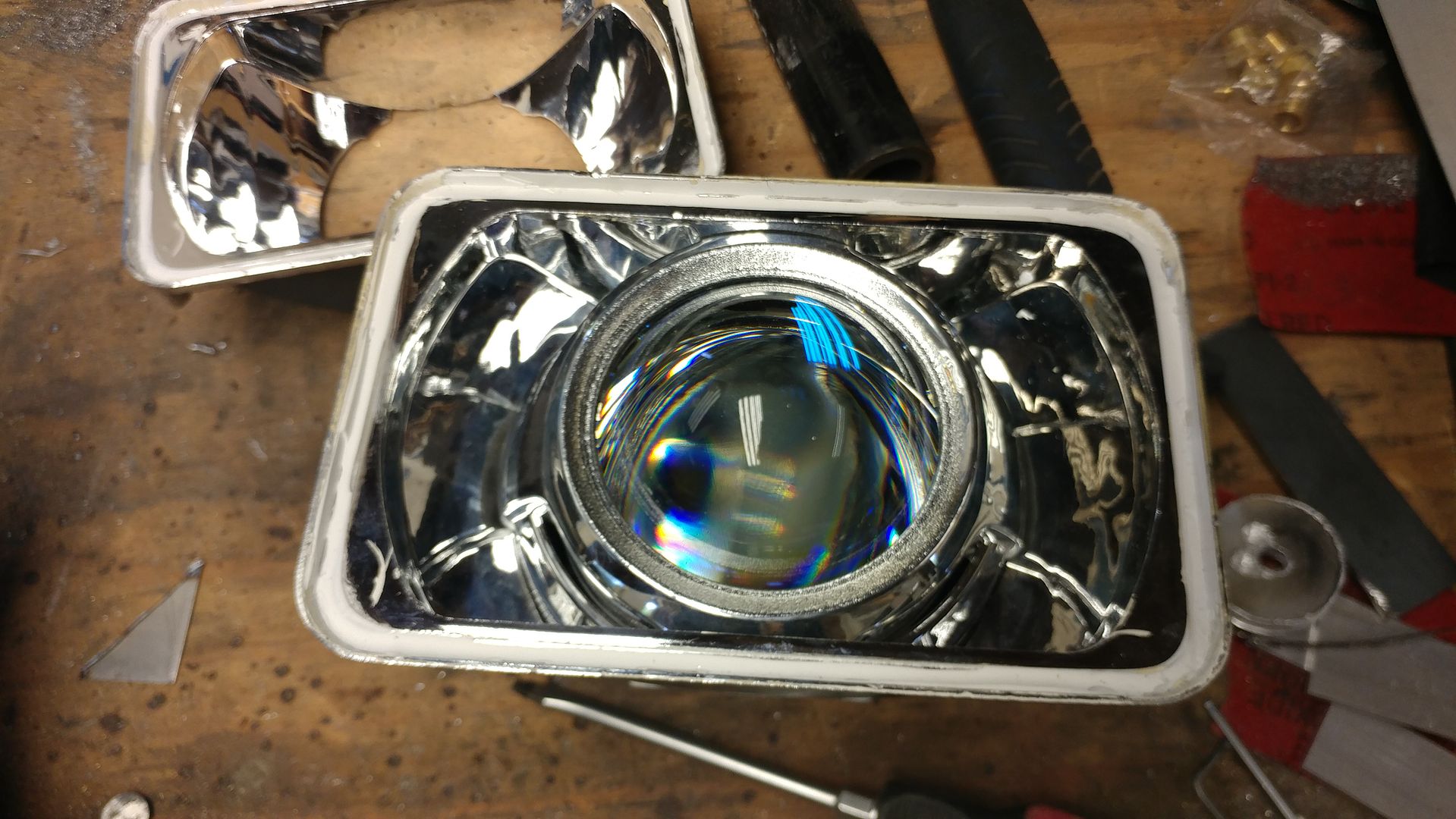

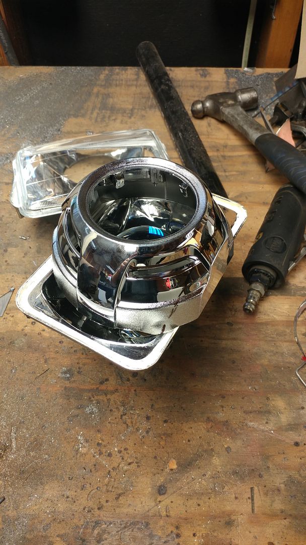

    test fit with no shroud
    I didnt get a picture of this, but basically had to cut this down to fit in the housing around the projector. Just a little at a time. I drew it out and went from there.
  • #2
    I just used silicone to put the glass back on, but they do make a rubber glue for this. Silicone is easier to pull apart, after my old set I wanted that option just in case.. I didnt get any pictures of the back, I thought I did.. I just used an aluminum color silicone to seal it all up somewhat cleanly. Few spots I had to build up with multiple coats. The shroud locked the projectors in pretty good so I didnt actually mount them. For my old set I actually made brackets and bolted them down to the housing. I was going to use JB weld on this set and make a nice flange to mount them down to, but meh. Its all the same, I decided it wasnt worth the time involved even tho it would have looked a lot more professional.

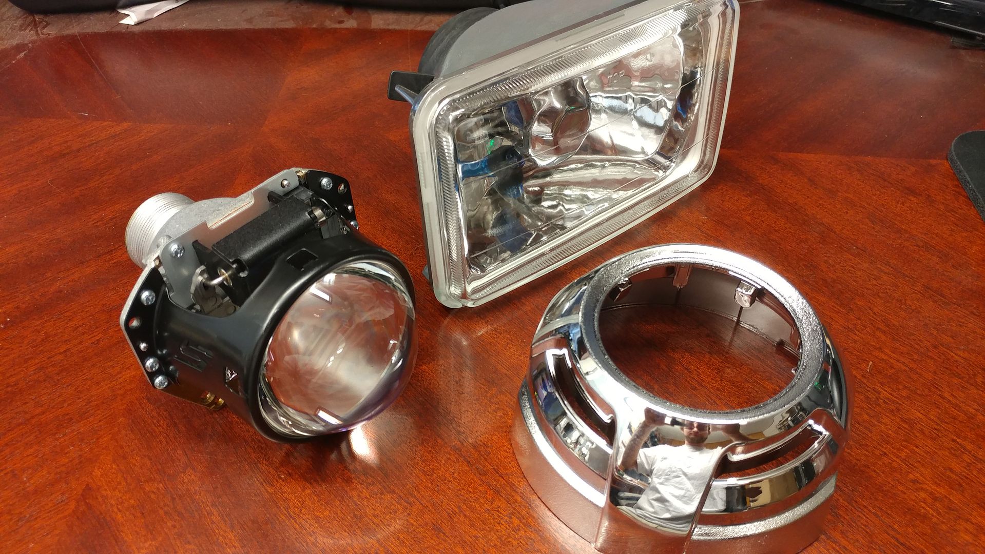

      Old projectors vs new projectors
      Dims, VERY nice cut off.
